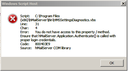

Re: Persistently getting "Access denied" despite correct everything
This is what I am getting:
Am I missing any software to be installed?
Wrong password. You need the administrator password.
Right. Sounds like my admin password was left blank since I started getting the popup about it being invalid every time I opened the admin UI. I set it to some value, and here is the file.
What is your current issue?
