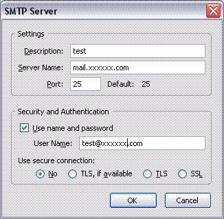

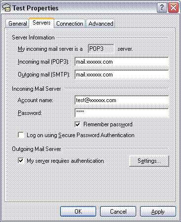

Post by gweeks » 2008-01-24 13:10
I am using Outlook 2000. I have other email accounts in this copy of Outlook that are authenticating with other servers and they are set up the same way.
Here are the settings. These work to retrieve mail
And after I click settings... for outgoing mail server
I also tried with Thunderbird with these settings and had the same result.
