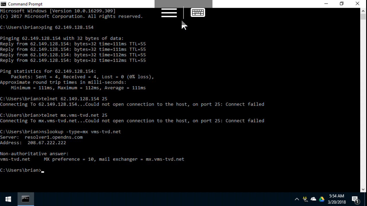

Yes, hmail. I'm not 100% sure about this, but autoban goes against a user and an IP. So theoretically, if you logged in with a bad password via cell network, AND you misconfigured autoban to hold the ban for a very very long time, AND autoban banned your login from the cell IP, AND you later corrected the password and logged in via WiFi on a different IP, then you could log in successfully after on any IP other than the cell IP. The problem with this theory is that cell IPs are dynamic and change every time you connect. So it would have to be a range of IPs that get banned in order for autoban to be the issue.
So... That's why I think it's more likely that the IP ranges are misconfigured somehow. Or it's possible your router is keeping a certain IP range from accessing hmail. Or you have a software firewall that is doing the same thing for some reason. Either way, something is preventing your cell service IP range from getting in, or hmail itself is booting your cell IP range out.

Post by palinka » 2018-03-20 12:02
Forget about IP ranges. Nobody can get in.
I think Matt was right. Your login is using the local lan address. Are you using a VPN to the machine that has hmail installed on it? That would explain why it works in outside locations.
