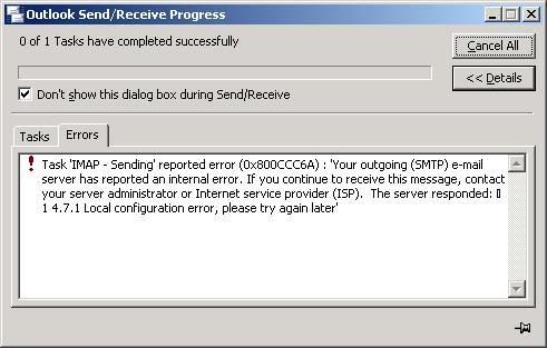

my hMailServer-5.1.1-B341 can't working when i try connect by
telnet 192.168.0.100 25 it's will always show below message
451 4.7.1 Local configuration error, please try again later
when i login to squirrel mail i can see my maibox but cant send out
squirrel will say same as telnet
Message not sent. Server replied:
Requested action aborted: error in processing
and in outlook i can't send out and it say as below picture
but hmailserver connect to mysql correctly and i can access
hmailserver administration program
i try re-install hmailserver many time but not work
how to fix this problem, can any one help me for this issue?
Thank in advance

when i see in log file i found this message
"ERROR" 3780 "2009-07-18 14:56:41.549" "Severity: 2 (High), Code: HM4316, Source: TCPServer::Run(), Description: Failed to bind to local port. Error: Only one usage of each socket address (protocol/network address/port) is normally permitted. Address: 0.0.0.0, Port: 25. This is often caused by another server listening on the same port.To determine which server is listening on the port, telnet your server on port 25. Make sure that no other email server is running and listening on this port, and then restart the hMailServer service."
but i not have any mail server except hmailserver on my server
how to check what program use my smtp port?

Personally I use TCPView from sysinternals - http://technet.microsoft.com/en-us/sysi ... 97437.aspx

OK i solve it by TCPView, Perl.exe used my SMTP port and i'm stopped
But why perl.exe take that i don't know can any one suggest me

And my last problem
My outlook working fine and telnet OK
But in squrriel mail not work i can read new mail
but can't send out, What's a root of my problem?
ERROR:
451 Please try again later.
Thank you again

You were stopped by greylisting because you did not authenticate. Please take a screenshot of your internet and my computer ip ranges and attach them here.
